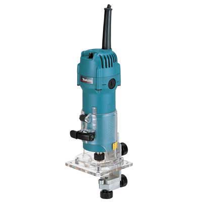

I never hear anyone talk about Makita laminate trimmers. I have one and plan on getting another sometime in the future to leave set up on my binding jig full time.
I love this little trimmer, does everything I throw at it. It's great. And $120 canadian to boot.

I scored this one on ebay for $20.00. It looks just the Makita. It's a Superior SPT 189. The price was OK. I haven't put it into action just yet. It maxes out at 20,000 rpm's?

I have 4 of the Makita 3707FC's I love em.
I have one of the cheap makita-esqe knock offs too. IT totally sucks.
